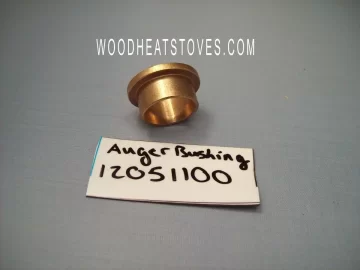

The brass bushing in the Avalon Astoria has really dried up after 3 season and needs attention.
So I started looking for a brass bushing when I can across this info about whitfield's brass bushing!
http://woodheatstoves.com/brass-bushingaugeroilite-p-2846.html?cPath=499_502
My brass bushing looks exactly like the one in the picture!
Travis Ind calls it an Auger Drive Collar part # 91002021

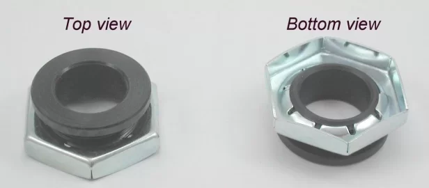

It has been recommended for many years that brass bushings be replaced by nylatron bushings on the Whitfield pellet stoves. New auger motor's warrantys are voided if the bushing is not upgraded to nylatron version which you can find by clicking here.
Most older models came with a brass bushing installed (which has been prone to failure, and can cause auger motor failure)
If your Whitfield came with a brass bushing, you will need a new end plate as well, found here: click here for auger end plate with new nylatron bushing

I believe they are different diameters and the hole pattern for the plate will be different but I do not see why a nylon bushing wouldn't work if it is the right diameter and depth
Yes, the nylon bushing for the Magnum BabyCountryside would work if it is the right diameter. If the brass is a different thickness than the nylon then even the same diameter may not fit. Could be tricky but I would really like to find an upgrade so the brass bushing would not have to be replaced every 3 years for optimum performance!

Would the Whitfield nylatron bushing fit into the Travis Avalon Astoria bushing plate?
Looks like it will not fit from what it states here. :-(
http://woodheatstoves.com/auger-bushing-threaded-nylatron-pp4000-p-16917.html?cPath=499_502
