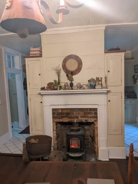

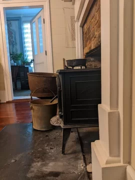

Here's some photos. The stove is really not extending out into the rooms much.
[Hearth.com] Should I buy a Palladian?[Hearth.com] Should I buy a Palladian?
Is there an insulated block-off plate installed in the damper area of the fireplace?
View attachment 290480View attachment 290481
Doesn’t look like you would have the room to move the C3 out, I was hoping you had enough height in the fire place for a tee on the liner and then a short run into the stove. Bummer cause the C3 looks great in your shape. Does the chimney have a block off plate? Just desperately grasping at straws hoping to find a away for you not to change out your stove….
