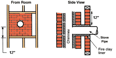

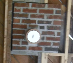

I had a "mason" install a chimney for me. I didn't find out after the job was done, that it's wasn't done correctly. I believe that there should be 12" of brick all around the thimble, but as you can see. It is far from it.
Does anyone know, once it's fixed, how close the drywall can be to the thimble? The current brickwork is flush with the studs so I can put Sheetrock right up to it.
