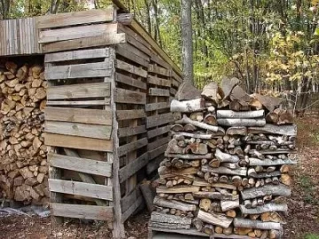

Here's mine before the rest of the bracing was done. Holds four cords easily.

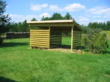

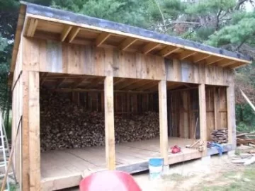

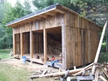

Here's my shed . . . before it was filled.

Holy smokes Jake, how many cords can you fit in that shed?
I figure 10-11 cords . . . figuring conservatively. Two years worth of wood . . . I like to make sure I have plenty of wood . . . just in case we get hammered.

Excellent shed Jake! Rough sawn pine I assume?
