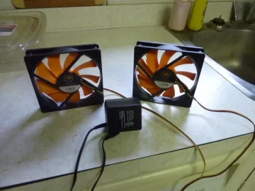

Personally if I had to go that route I would install an active vent. Lots of places sell them, some even in aluminum ductwork, etc. I always find that the most quiet fans are computer fans. They run on 12v and are super quiet. Yet they push a good amount of air. The average size is 4-5 inches and some run at only 15-25 dB.

I like the computer fans as well. Many different sizes available and quiet. The nice thing about them is you can vary the voltage anywhere from usually 6 to 12 to vary the speed. I run 2 on a lower speed instead of one and can't even hear them.
If I run a computer fan then I need an inverter right? And to fit that all inside a wall?
I'm worried about making a mess of the plaster. :(
Those small ac to dc adapters like for charging have enough capacity as the fans take very little power.

That adapter is enough to power these 2 fans. 4 3/4 inch, 17.7db, 60cfm, 1200 rpm
