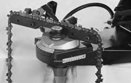

I have been looking into milling. I have plenty of trees, equipment, barn space to store the final product, and plenty of projects to use the final product on - but I have not milled a thing other than a failed attempt to make a square post. All I need to is buy the bar guide and rip chain and I would be milling that very day.
Set the tilt angle looking from the side of the grinder.
I use the tilt angle when grinding my ripping chains.
Setting vise-tilt angle. For saw chains
that require down-angle grinds, set the
desired angle by loosening the large
adjustment knob on the bottom side of
the grinder vise assembly. Then move
the positioning table to the left (forward)
for right-hand cutters, or to the right
(back) for left-hand cutters, to the
desired degree setting. Once the degree
mark is aligned, retighten the large
adjustment knob.
