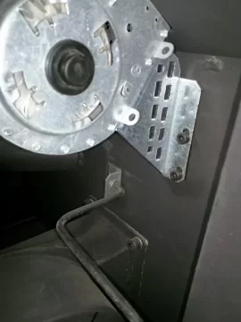

To adjust the airflow from the front of the stove you need to remove the left side panel and there will be a shiny slide plate towards the front down low, pushing that slide plate in decreases airflow, pulling it out increases airflow. In the photo you can see the slide plate below the room fan with the black rod I attached to make it adjustable without removing the side panel. Serenity pellet stove shuts down on its own a few times a day... HELP
