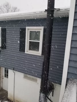

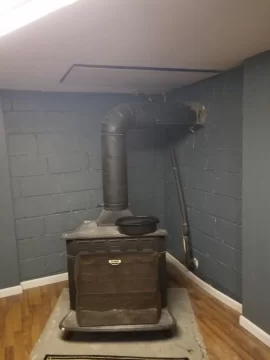

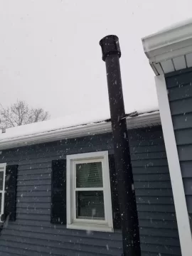

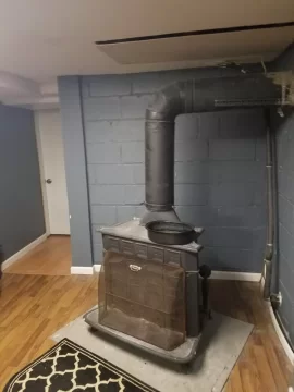

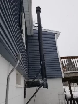

I know this one has been beaten to death, but the stove has a 6" flue. If I change the pipe inside the house to 6" and instead of the 90° (see pics) change to 2-45° inside the house, will I be ok with the existing 8" run that's outside?

The 2400M should have 6" all the way according to the manual. Is that outdoor chimney made with class A chimney pipe or is it stove pipe instead? If stove pipe, it all needs to be replaced. The best installation will have 6" double-wall stove pipe and 6" class A chimney system going through the wall and up. The good news is that the hole through the wall is already 8" to accommodate the 6" class A chimney pipe as long as it is not triple-wall.
Using proper class A chimney will allow the chimney pipe to be much closer to the house (2"). That will reduce the long horizontal run which is another problem with the current installation.
Lastly, the 2400 is going to be more particular about burning fully seasoned wood. Feed it dry wood and you will have a nice fireview, clean glass, more heat burning less wood and a much cleaner flue.

The current setup is completely against code and uninsurable. It also looks like a creosote maker too. I am surprised that a sweep will work on it.

I am sorry to be so blunt but if your sweep passed that setup you need a new sweep
I would not work on that. Doing so would just open myself up to to much liability
