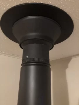

Something like this? I struggled a bit trying to decipher the instructions also, it was my first install, so the part names were new to me, it just took a bit of patience & thought to get the puzzle together. It doesn’t leak air or smoke so I guess I did it correctly.
That looks correct. Typically the trim collar would cover the crimps though.

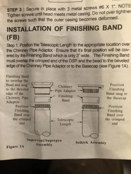

I think these are the instructions you are talking about

The crimp was almost 2-1/2” long, I couldn’t get my adapter & telescoping end shoved any farther together. I was concerned about a possible leak but haven’t noticed anything yet. I have about 1-1/2” of crimp covered with the band. It’s not as pretty looking as the picture shows but I believe it’s functional & safe. I am going to cut a wider band out of a length of black pipe to make it cover as per installation manual.
