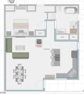

I’m building a 900 square foot, single-story house in the Blue Ridge Mountains, about 45 minutes northwest of Asheville. Altitude 2300 ft.
We do have a real winter, tho it’s a winter that might seem like a shoulder-month to someone from Vermont or Upstate New York. I want to make sure we stay comfortable through all three seasons the stove will be used. In other words, I don't want a stove that will fry us in April, so that we can be toasty warm in January.
The stove will be in the center of the house, right at edge of the living room. It would seem that a stove that provides lower, more consistent heat would be better suited to our situation than one that blasts out and then attenuates. Is that right?
So, right now I’m thinking about the Blazeking Ashford 20.2 (is the 30 too big?), the PE Alderlea T4 (is the T5 too big?), the Jotul F45V2, the VC Dauntless or Encore, or the Hearthstone Shelburne or Craftsbury.
Since the house is not yet built, I can make whatever adjustments I need to the plan to accommodate the specific requirements of the stove I choose.
From my research, it would seem that a catalytic stove like the Blazeking will provide the energy profile I’m looking for. But don’t catalytic stoves need a longer pipe? That might be hard to accomplish (or look odd) since this is a one-story house.
Also, how much should having a high ceiling in the great room affect our choice of stove (the bedroom and will be at 8')?
Many thanks
