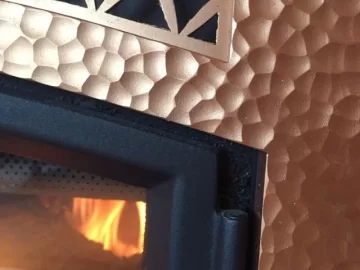

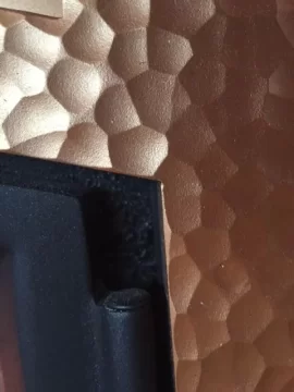

Is there any way to explain this other than a bad gasket? The stove is 3 months old, could the gasket have been not installed evenly?
Holding a dollar bill against that area with the blower off - I'm not seeing a noticeable movement. This is the first I've noticed it this season, burned 1.66 full cords so far.
Thanks
[Hearth.com] Seeing buildup near my door hinge - bad gasket? [Hearth.com] Seeing buildup near my door hinge - bad gasket?
When the fireplace is cool, examine the gasket there to see if there is debris embedded in it or it is frayed around that location. If possible maybe fluff it up a little there.
Thanks for the reply I'll try that.... It couldn't be liked burned off excess paint or anything like that could it?
Hard to say. If you clean it off and it doesn't return I wouldn't worry about it. How is the FPX working out for you so far?
