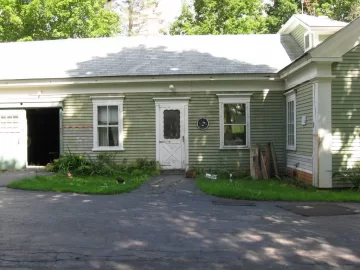

Our wood shed is really convenient - it's continuous with the kitchen L .
There is a door out to it from inside the kitchen. Never have to outside for wood all winter long.
Edit: Well, I guess the bad part about it is that once the wood goes in there continued drying probably comes to a near halt.

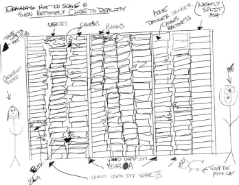

What I did in my first year with my woodshed has worked out quite well for me.
I loaded up my "freshest" wood in back to front on each side . . . figuring that having the most exposure to the passing air would continue to allow this wood to season in the year it would be under cover (and this is after it has been outside for a year.) The next oldest stuff went into adjoining stacks . . . stacking back to front rows which means the rows are shorter vs. stacking side to side, but the flip side is that I can pick through the stacks and not worry from year to year about the oldest stuff always being buried behind the freshest stuff . . .
What has worked out now is that typically in one year I will end up taking wood from the two sides . . . leaving the wood in the center stacks . . . and then in the following year I take from the center stacks . . . and so on and so forth. It has actually worked out quite well.

Hey Jake, do you suppose adding Cameron Diaz to your artistic endeavor might be just a bit optimistic? ;-P
I'm still working on the woodshed rotation plan, seeing as this is the first year having it.
Somehow, there's wood in there that still sizzles a little. That ain't right.
Jake, you're a genius!!
I 'm gonna get George Clooney to process all the wood this year!
I did say the drawing was not to scale or even remotely based in reality . . . ;)
Oops, missed that notation. Right on the money! hehehe
