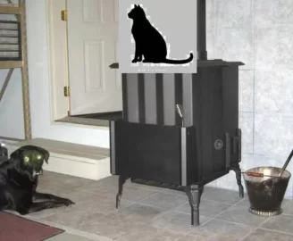

Just think of the possibilities, with the stoves unique ability to burn manure, one could preform a simple modification, to create the ultimate perpetual heating appliance.
Installation of a properly configured cat. ;-)
  • [Hearth.com] Sedore stoves - never seen before
