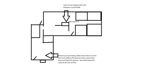

My concern is the room is quite small SQ FT wise, and will probably overheat quite quickly, even on a maintenance burn, and depending on heat loss, it might stay that way. If this is the case on/off might be the best route. I noticed you liked keeping the room @ 58*, do you keep it this cold to save money on oil, or is this your comfort range?
