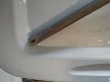

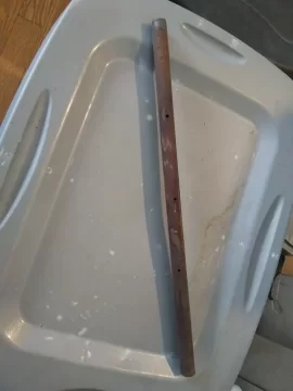

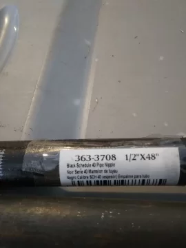

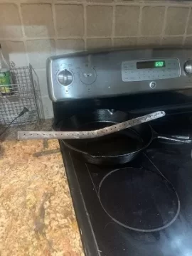

Can you straighten the tube out for a temporary fit?its' only one tube that's bent and I took it all the way out
the other 3 are still intact
Clamp a short 6" section of 1" pipe in a vice. Insert one end of the tube into it. Slip another 18" section of 1" pipe (1") around it. Gently persuade it to a flatter shape. PVC pipe would probably work for this.How do you bend a secondary tube? I've hit mine numerous times trying to get 1 more piece of wood in for overnight burn and never bent one.

My first attempt would be to straighten the tube. The next would be to safely block the open tube holes.
