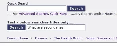

BeGreen said:A search will get you more info than you can read in one night, with pictures and movies too.
