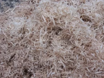

Have been noodling these big wet pin oak rounds, some are 3 feet or more across. With a sharp chain, i'm getting noodles that look to be the same size as in the online vids (see pic), but it's taking a long time, as in 3-4 minutes to make a cut of 2-3 feet in length. And I'm lucky to get through 3 separate cuts before I need to stop and sharpen the chain.
The saw never seems to bog down. It's a Husky 450 which is 50 cc and has the stock Husky semi-chisel chain. Previously when I've sharpened the chain for crosscutting, I've gotten good results, and I'm sharpening the same way now.
With the larger rounds though, with the saw buried up to the bumper spikes, the nose of the 20 inch bar is barely showing outside the round.
Is the slow cutting likely due to some deficiency of the chain, or due to the 20 inch bar being too short, or due to the need for more horsepower?
The 20 inch bar is the longest this saw will take.

Dude Your looking Good and a 50cc saw I would idle for a min after each cut and let your saw cool.....Fantastic Job for a 50cc saw!
a 20" bar on that saw is pushing it to begin with, especially when fully engulfed! More HP is a good start, but an expensive one at that

But if HP were the problem, wouldn't I notice the engine slow or labor with the cuts? It never seems to lose RPMs as best I can tell. In fact, sometimes it seems to race, like when the chain is dull, and it stops cutting. If I rock it up and down like in crosscutting, then it starts cutting again, making me think the noddles are not clearing the cut.
It makes me wonder if this chain doesn't clear the noddles very well.
Do you file down the rakers at all when you file the chain?
I have been filing the rakers. In fact, I filed them down more than I really should have based on the gauge, hoping it would make these cuts go faster. But it didn't seem to make a difference.

No saw really clears noodles well was not made to cut like that...Its hard on a saw and chain but no more than you have looks to be doing quite well. Many things you can do to clear the noodles easier. With a 50cc saw your very best bet is just take Your Time.

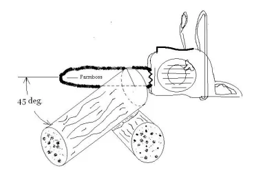

Haven't seen this suggested - noodling at 45 degree angle works better than whole length. Clutch cover doesn't get clogged
as quickly and short bar might not be buried. May have to flip over the log to finish from the other end. Works OK.
That's an interesting approach. Do you actually get noodles that way though? Some of the online demos show how you need to cut very parallel to the bark, and toward the heartwood, to get noodles. I found that's mostly true with the noodling I've done, but not 100%. Not sure it matters though, as long as it cuts.
I can't do the 45 degree approach here though, because the rounds are way too big and heavy for me to get into that position.
