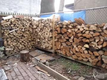

Thank you, bogydave, gryfalcon and jimbom!
jb- you're taking me by the hand right into that weird and geeky world that i can totally enjoy. thanks for the links!
bd and gf, thanks for untangling my over-thinking with plain english reasoning.
I particularly like, "older wood don't mean drier wood," because it puts it all in the right light. Dry is dry, no matter how long it took or by what method it got there.
So far I've had a bunch of fun stacking around the entire perimeter of my small but windy and sunny patio. I actually really enjoy the look and feel of my "wood walls." As long as I can stay at least a cord ahead each year, and keep the stacks well stocked, (and check to make sure wood is >20%MC, I think I'll be good going forward.
Again, this place rocks!
