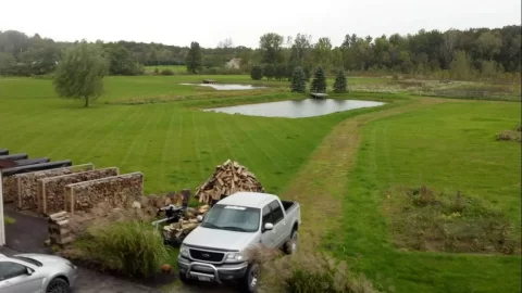

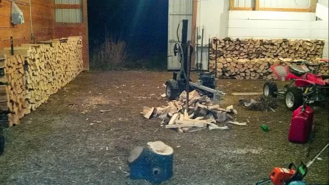

I haz jealous of your barn and stacking areas!!! So very very jealous....
