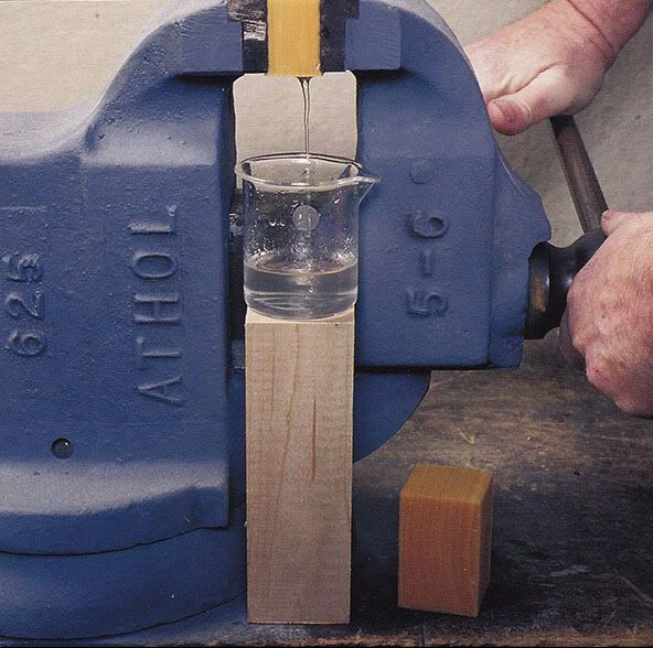

Battenkiller said:Wood stores water in two ways:
Free water - Like the water in a soaked sponge, it can actually be squeezed out with sufficient pressure. It is not chemically bound to the wood fibers, so it evaporates easily with little added energy. When it is gone, almost all species of wood will be at about 28% MC and will not even have begun to shrink yet, so it will be mostly crack-free. Below is a photo from "Understanding Wood", showing how much water can be squeezed from a small block of red pine sapwood (about 135% MC). Wonder why it won't burn?
Bound water - This is like the water that remains in a sponge after you have wrung it as hard as you can. Still pretty damp, eh? This water is a whole lot harder to remove, requiring more energy to break the hygroscopic bonds it forms with the wood fibers. This water has to migrate through the split by diffusion, and the denser the wood, the slower the diffusion rate.
So...
Locust is known to be a very low MC wood when green, but it ain't close to seasoned dry. Like ash, it has very little free water, but the locust fibers hold onto the 28% of bound water for a long time because locust is so dense. Bottom line is that locust may burn now, but will burn so much better in a year. I don't think it needs two, but locust will last 30 years in a stack and still be fine, so it a good one to lay down for the future.
