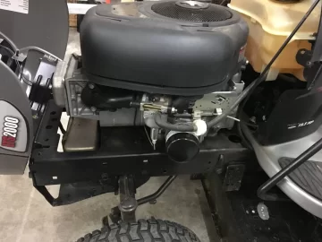

Pic 1 - old rubber foot pad that fell off

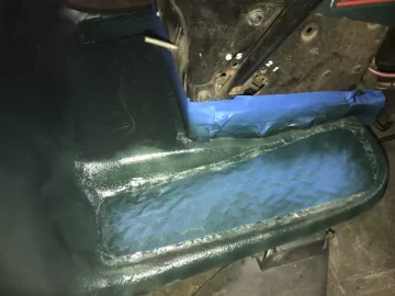

Pic 2 - metal is rusting away under it!

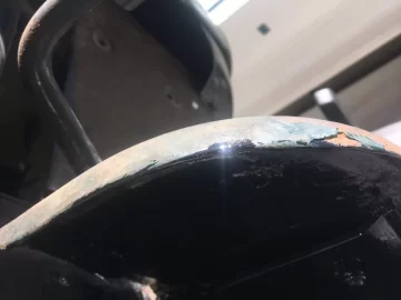

Pic 3 - cutting the new steel diamond plate
