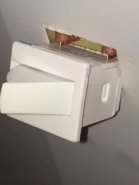

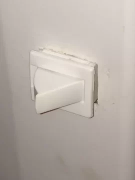

Has anyone replaced this switch?
Is it cheap and easy to get?
See pics

Show them the pic I posted and they will know which one it is!

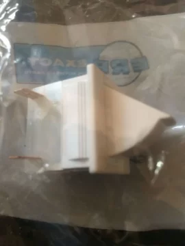

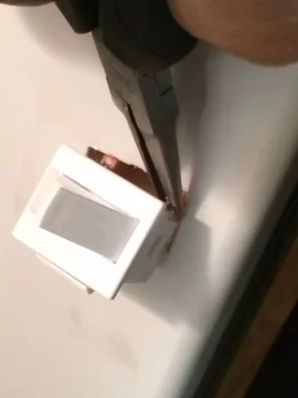

Got the new switch in the mail today. Getting the connectors on took very small pair of long nose pliers. Very tight spot!
It works!

Excellent! At least your wires didn't pull back out of reach. I had the happen on an oven element - as soon as I let go of the wires, they retracted up into the back of the stove, out of reach. I had to pull the stove out, remove the back, and fish the wires back into the oven cavity. The factory made the wires so short that they were under tension. A 10 minute job took over 40 minutes.
