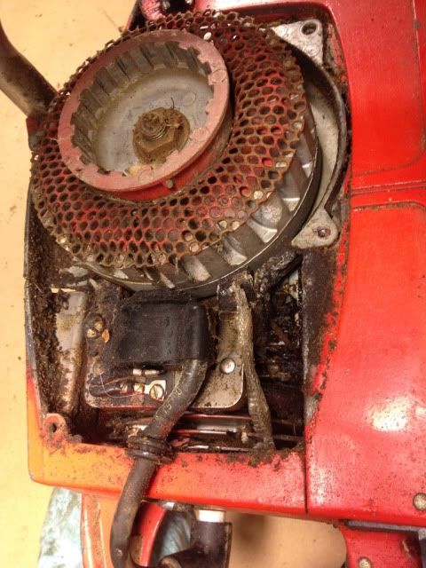

After fiddling with the saw, i think it was getting fuel, but no spark. It's really hard to see anything through the intake and exhaust ports, but what I can see looks good.
The coil/Magneto is bad, I think, this could be a hard thing to source. Here's a picture of the dirtiness that lies within the flywheel housing. Note the super awesome snake skin mod...

Just nuts and bolts! I found those lists and a service manual of sorts, too. After receiving some advice, it sounds like maybe I just need to clean the points up. Let's all cross our fingers on that. (it's NEVER that easy, though)
