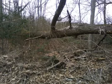

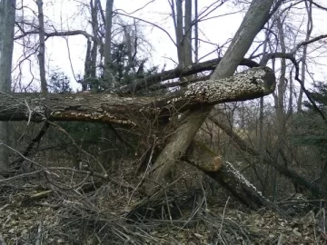

The Pastor at my church stopped by and saw the new stove going. He told me there were some trees down behind the Church parsonage (off site). I stopped by and saw this. Not to mention the dead Ash trees around plus other goodies. How would you guys approach this tree. Any help would be much appreciated.

In the first picture, cut off that limb first. Cut it to approximately 32" (depending if you want 16" firewood). Then lay those logs under the tree so when you cut the tree it will fall onto the logs you have down. If you think you need longer in case the tree rolls, then just cut some longer pieces. You no doubt can get one good one from the end (second picture).
Once you have some logs for the tree to fall onto, then comes the fun part. Just be careful. Look the tree over good to determine for sure if it will want to go left or right but based on the picture it appears it should drop straight down or just a little away from you, which is great.
Looking at the second picture, I would cut to the left of the crotch. You will stand on the opposite side of the tree from what is pictured. Cut the top not more than a third or just until you notice the crack coming together. Get the saw out quickly so it does not pinch. When I cut those I also cut the back side some. When that is done, you cut from the bottom of the tree. Be alert! Don't get your feet under the log either. Once it is down, it is easy to buck up into firewood length.
If you do try to drop that thing before you cut that one limb off it will definitely want to twist when you cut it. That is why you cut that limb off first and use the log to support the rest of the tree. Also, that way you won't be tending to hit the ground with the saw as you are cutting.

I would probally cut the left hand side of the big tree frist using a wedge get that end on the ground where its not so busy and work my way to the right.

I agree. Work that tree from the base up to get some pressure off .Those octopuss arms can really reach out and smak u on yur azz.Woodn't hurt to take that one limb in the first pic off if its not leaning into anything. If you don't it's gonna want to twist the top as you work your way up the base. I always use wedges even if just cutting wood, just so uncle pressure doesn't get your prize saw.

Follow advice above it's all good. Use your foot to push a bit on some logs before you cut it can often give you a good feel for how it wants to fall and try to stay above the cut on the high side of the tree so it falls away from you. Keep smiling while you cut that tree !
Yep, looks like that thing can roll on ya and kill ya for sure.
I'd take every limb off first, and that piece on the top end there too.
Then I'd work the trunk end. Likely standing on the far side of the tree as pictured.
I'd cut down through about half way or so, then pound a wedge or two in on top, facing kinda away from my face so if it pops it flys away from me.
Then I'd finish cut up from the bottom til she drops. By the looks of it you may have to do this a couple times.
Always a good idea to place a log/limb under the tree at different spots so it'll fall onto that, giving you easier bucking.
Only other thing I might try would be to pull it over with a come-a-long, but it appears to be anchored good at the base.
work your way from the outer parts of the horizontal tree, and keep dicing it up in 3' increments untill its outta the vertical tree's way. if it does not come down on its own, then make a hinge cut, and stand back.
