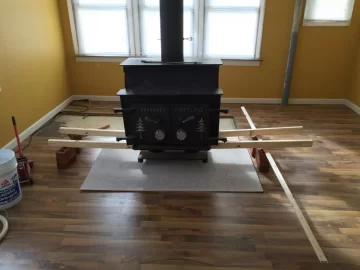

Go to lowe's or somewhere and buy a hearth pad before you burn your house down!
even a wool rug is better than what you've got there.
I'd hate to see you stuff the stove again and start to see the finish burn off the wood floor.
bottom line... don't be stupid.

there is no "perfect setting" as there is no "perfect wood". wood stoves are all about compensating for variables...
the little tray in front of the fire box will help... but it is not floor protection. my stove is very similar in that aspect.
The point I am getting at is, unless you put something under that stove (as it was pictured) you should not be operating it, at all. You WILL be SOL if there is a need to file a claim with your insurance co.
a hearth pad/stove board is less than $40 at Lowe's... and surgery or not... needs to be put under it. Hell, I've got 2 cracked ribs on my right side... house still needs heat... so I use my left arm to carry it in.

By all means, put at least a type 2 hearth pad (~$100 at the hardware store) under the stove or you may soon burn your house down. Even that is probably insufficient but better than the big nothingness you have right now.

Yes, Im building a ceramic tile pad on tile board (fireproof) to place under it.
Floor never gets hot unless I have a massive fire going ( did that once) but overall the floor stays cool, has the fireproof hearth pad in front of it that supposedly passed as the inspector didnt say a word. (and didnt have the pipes installed either at the time)

I agree, and my insurance is actually really cheap out here, I pay less than 550 a year and thats covering my entire home with wood stove. I installed a fireproof floor under the stove today, wasnt an easy task alone, but got it done. Also picked me up a rank of white oak, may get a couple cords since its cheap and I already went through all i had.

Soory to say but a layer of cement board is no where near enough insulation under that old stove i would not run it with less then 4 layers of 1/2" under it for insulation. Or better yet is that floor over concrete? if so just cut the wood out and lay tile in the opening

Im not finished yet, Installing ceramic tile on top of it, I asked the inspector on the code and he told me what to install.
Is this the inspector that oked it with out the board to begin with? That old stove needs way more than what you have unless it is ul listed which i doubt
No he is no longer inspecting...lol
This was a fire inspector I asked this time... This stove, I dont know much about but they looked it up and said what I needed minimum, or I can beef it up, which I will beef it up, as there will be another layer then the ceramic tile installed on that, that way I can also use the ceramic edging to finish it off to look very nice. I am also installing steel railing around the trap door opening behind the stove so I can eliminate the trap door access to the stairs to the basement, then the staircase will be walled off and a door installed at the bottom of the stairs.
The spects I got were based on the diminsions of my stove and the clearance to the floor as well,
