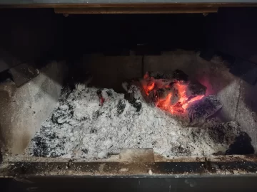

I scoop ashes when it's like this. This creates enough draft in my system to suck anything flying up the flue.
But maybe that's the benefit of a cat stove with a bypass that allows things to bypass the baffle (and cat) when open?
