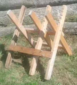

Just cobble together something like this from 2X4's. The screw-eyes (if they show in the pics) are to bungee cord any pieces that want to flop around while sawing. It folds flat to store. Sawbuck for small rounds Sawbuck for small rounds

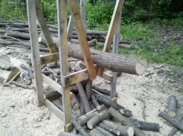

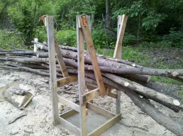

Built with 2Xs from pallets

Thanks for the ideas, guys. All good stuff. For what I have, HDRock's system would work especially well because it would allow me to stack several rounds at a time. And even I could probably make one with what I have;) .

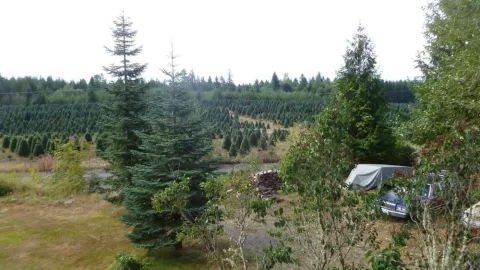

This is about 1/4 of the tree farm that I have access to (from my roof):

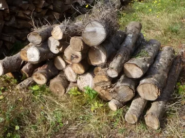

This is what I got yesterday. I c/s/s it as I get it. Doesn't look like much, but it adds up. I have about a cord stacked now. A lot of it doesn't even need cutting, a lot of it is odd lengths so I end up with a lot of small chunks, but that's fine. I never realized that they cut so much trunk off when harvesting. Some are 4' long. Sawbuck for small rounds

This is what I got yesterday. I c/s/s it as I get it. Doesn't look like much, but it adds up. I have about a cord stacked now. A lot of it doesn't even need cutting, a lot of it is odd lengths so I end up with a lot of small chunks, but that's fine. I never realized that they cut so much trunk off when harvesting. Some are 4' long. View attachment 109488
That looks good. So you will get approx. how many cords a year if you get out there and gather every stump you can?
LOL. Until my arms give out. I hand carry most of it, although there was one very large pile of long ones stacked up against the fence along the road. That was my easiest score because I loaded them up in my old Chevy Chase station wagon. If I see them doing that again, I may bribe the workers to bring it on over to my place and dump it. There are many cords out there after a harvest if you get it before they burn it themselves. There are access roads all through there, but I'm trying to keep low profile and they don't mind folks walking around. Making several trips a day keeps me active anyway.
Other than that, I could get kind of obsessive about it and not know when to quit. Like my dog and frisbee. I can get that way sometimes. All I need is 2-!/2 cords a year, but I'd like to get as far ahead as possible while I'm still physically able to do it. Including the alder I got last year, I'm about 3 years ahead now.

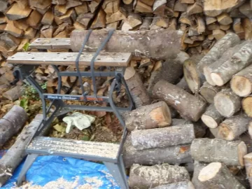

Well, it looks like I may not have to build anything after all. I nearly tripped over this old Workmate today and thought hmm. This is part of what I gathered yesterday and this morning.
Works perfectly well for what I have. Anything around 6" clamps in; 7 or 8" needs rubber straps but cradles. Much over 8" doesn't cradle well enough. I may still build a proper buck yet, but for now, this is good.

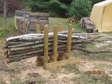

Made mine out of 4X4s but could have used 2X4s. It works good. I am clearing land with a lot of small pine, maple and choke cherry and don't want to throw any away.
That looks great for large loads.
That is the kind I was recommending for cutting slab wood. Makes the task go much faster.
