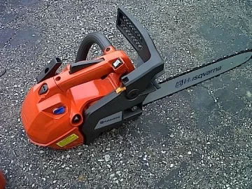

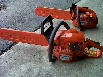

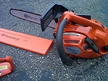

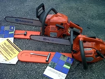

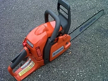

My 435T is not a Pro saw But you would be surprised. Also a 435 (Standard) that I am about to sell/trade.
Both are about 4 months old and been used 3 times. For almost an hour of use Max. Still have lots of Paint on the Bar. Just looking to trade/sell to get some bigger saws
New cost is only $299.99 for the Top Handle. $269.00 for the Standard 435.
Would have PM'd but cant post Pics in a PM and would rather you see.
Cant comment on the 346XP. And if this does not look or sound appealing (Have talked in PM's with you. I know your a "Pro" Saw guy). Then disregard.
Sorry for the hi-jacking...
