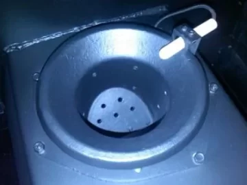

My Pot still looks like new. Every year.
I have burned 13 different brands throughout the years.

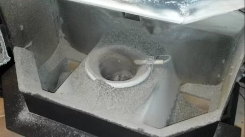

I would think that there cleaning regiment would play a large part also. Not cleaning the stove and/or living in a Humid area, no A/C in the home, Etc. Cast can last a long time when kept up. But if its let go... Look out. [Hearth.com] Salty Wood pellets rot quad fire pot!

Dexter that thing is way too clean. Run a few hundred bags through that thing and post another picture :)
Just one burn will make a big difference!
