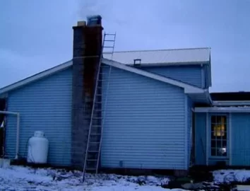

what causes a rusty chimney? as in rust stains weeping down the outside of the masonry and down the nearby shingles. maybe previous owner had a cheap cap on there for some time? it's curious, it's only around the one flu, but down all 3 of its external sides.

Our house had a similar rusted nasty mess when we moved in. What are you going to do with it?
I can't tell what I'm looking at, what is used for a cap now?
That is the result of rain dissolving the creosote on the chimney top and cap and running down the sides of the chimney and onto the roof. Not rust.
Looks like a cheap piece of steel or old galvanized metal was used in this poor example of a chimney cap. If it was stainless, this would not be happening.
It would also help if the two flues were not of the same height. But that is a separate issue.
creosote. damn. ok, thanks chief. no real surprise there I guess. I just gotta get an EPA stove, this old Fisher is a waste and a hazard, and I don't want it doing THAT to my new metal roof going in this week! any cat users here in the Finger Lakes region, maybe near 13021? I am really keen on a cat, but I would love to meet with an owner/operator and see first hand the ins and outs before I commit. I'll bring the homebrew! any takers? SolarAndWood, you're in Syracuse??

Just to confirm my thought and that it could be what BeGreen said, a steel chimney cap that has rusted......What is the chimney cap material? Its just that I have seen this exact situation many times and it was disolved creosote.
not sure how long cap rust would persist, but I know that this chimney has not had a metal cap in at least 4 years. the current "cap" is a piece of slate propped over the top on a couple piles of bricks, something I just make-shifted to keep out the rain. amazingly almost no powdery or chunky creosote in this chimney, I can't believe how little material comes through the cleanout, but some serious glaze.
for the record, the flue on the right has not been used in a LONG time. I think it used to connect to a wood furnace in the basement...there's a rusty crusty one in a corner down there...but now there's a propane furnace hooked up that has probably been there a decade.
OK, I am sticking with creosote then. The glazed creosote is hard and won't fall and is very difficult to even brush out.

Rust is red. That looks black. It may be the color cast since this LCD at work is terrible.
We had similar problems when we first bought this house where the previous owner had done a DIY job of making a spark arrester. In addition to redoing the chimney cap, I ended up taking a steel brush and brushing the bricks. If you do feel a need to do this, be careful not to brush out too much mortar.
here's another shot where you can really see (1) that nasty stuff dripping down the outside of the chimney and (2) my beautiful new roof going up in the background.
