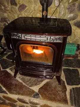

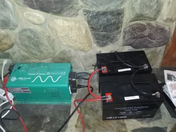

I have Inverter Charger (AIMS Power PICOGLF12W12V120AL Green 1250W Power Inverter Charger) for my Pellet Stove with 200ah batteries (100ah ea). Good for 12-18 hours at best. Longest without power has been 10 hours and I then had only one 100ah battery and used 30ah to get me over the hump.
Have 7k Generator for house, Fridge, Pump but it's not Inverter.

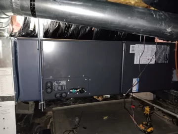

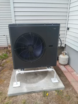

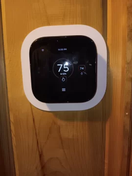

So if it goes longer than day I can still have heat. Tested works great. Have yet to use it really more than testing. Pellet stove this year is for really cold temps (Sub Zero). We put in Extreme Cold Weather Heat Pump (Madea Evox G3 - They Make Carrier Unit along with others) good for -22f. Time will tell. Very mild Fall Weather. Heat Pump is using about 9kw or 60 cents per day for heating. Vs half to full bag of pellets ($7 bucks with delivery). (Pass thru in Closet for Extension Cord for Generator so don't kill ourselves with exaust, ie PVC Pipe with cover.
Typically Winter here is not that Extreme. About week of sub zero at worst. Eastern WA State (Newport WA).
