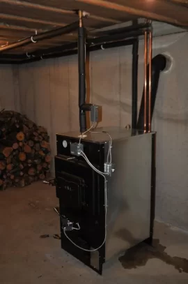

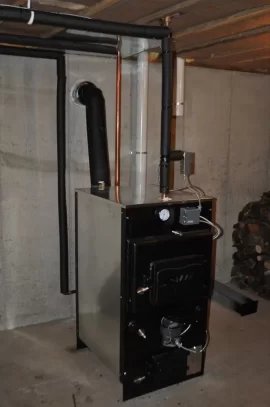

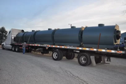

Here's one we just did.
In between the Jolly Green Giants.

Jolly Green Giant I like that. BTW nice install, wish that was a picture of my basement :)
Thank you very much for the compliment. I'm blushing........
That install was about as easy as they come.......other than 27' of stainless steel chimney up the side of the log house it's in. Outside the wall behind the boiler the ground slopes away from the house so steeply that we had to get a 50' man lift in order to reach the peak of the house. The chimney and labor to put it up cost more than the boiler.
I'd like to point out one thing.
Despite having that much chimney, the boiler would smoke you out of the room in a heartbeat. Starting a fire was a pain because of smoke coming back into the room from the open door. I checked the flue with a basic "Bic test" and it was drafting back into the house like mad. Drew opened a window in the basement and the flue reversed within 10 seconds.
We cut one 4" hole through the rim joist and tried again. It still would not draft. When we added a second relief/combustion air opening the flue took right off. A draft gauge showed between .05 and .08 wc" depending on the wind speed that particular day. We did not cut in a barometric........yet.......I want to see how the system acts once we get into some normal winter weather.
You can get a glimpse of the 2 4" PVC combustion air "ducts" to the right of the boiler in one of the pictures.
I will offer one caution to you. The 6200 is rated at either 200 or 250,000 btu and like to work with a pretty substantial load. If your heat loss isn't in that range, you may want to consider a smaller boiler or adding some storage capacity to the 62 in order to lengthen burn times and get the flue hot enough to prevent problems. These are not "idle friendly" units by any stretch of the imagination and should be sized pretty accurately for best results. I told the owner of the boiler in the pictures to not even think about burning it when outdoor temps are above 35-40*. It would only cycle a couple times an hour under those conditions.
Well I guess with that tall of a chimney outside I would guess the house is more than one story? New home sealed up pretty good? I forget the correct terminology for it but I think its called a neutral draft area or something, that you must have been fighting with.
I have 6500 of "potential" heating but only about 3800 with an average of 65 degrees. I should be able to use every bit of the 250,000 :) shoot I think when I did some rough calculating I was around 325000 to heat it all. Plus I plan to run off storage.
Two story with 9 foot ceilings plus gable end and terminate 2 feet above peak. 12-12 pitch on the roof. Oyyy
The house is tight. Chinking is sound and everything else is spray foamed. A bath fan would pull the place into negative pressure. Hence the combustion air openings.
You'll be fine with that 62 especially with some storage, which does wonders for any system.
Well at least everything worked out, its always nice when things work out in the end. Also you mentioned earlier about it being a simple install, one would think "simple" means a neat and well orgazined finished product...Some of the stuff I have come across that someone has tried to do a "simple" install are far from neat and organized when they finished. I am sure you have seen plenty of instances where it would be a "simple" install and it turns out looking like plate of spaghetti and that is just in the plumbing world, not to mention all the other trades that get hacked. Your install looks clean and tight even for a simple job, it goes a long way in word of mouth sales.

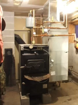

Very Nice install. Mine is in a room off the garage so venting is not an issue, it barely smokes at all when loading. I did set mine up 8 inches off the floor on blocks so I wouldn't have to stoop so low when loading, lighting, and it makes it much easier. These units do not like to idle, i can attest to that.. I got rid of that goofy tongue in picture that was on it when I first installed. Don't need it. Previous owner did not have storage so it idled a lot and that tongue kept the goo from dripping on blower fan.

That is a nice looking setup mocus. Have you ever used those wax bricks they sell at wallyworld? When I used to burn my jotul that is all I used to start fires, no paper needed just some kindling, wood and a match to light. Mine would smoke with a cold stack and the door open, but with those bricks you could close the door and walk away. I made my own a few times but its easier to just buy the stuff. I break them up into halves or quarters depending on what I am lighting.
