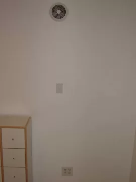

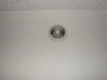

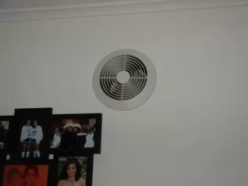

So I decided to purchase (4) Broan Room to Room fans along with (4) variable speed switches. The units are only 6 inches in diameter and get mounted in the wall. It was an easy installation and they look very nice. What really helped was the purchase of a 6 inch hole saw (continuous grit) made for drilling holes for recessed lighting. It made for a perfect circle and a nice tight fit for the fans. Wiring the variable speed switches was easy also.
