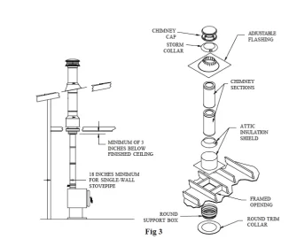

It needs a ceiling support box installed between the joists. Before buying anything, download the installation manual(s) for the chimney that you intend to purchase. It will have installation instructions. A typical install will look something like this.
