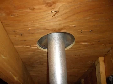

That's correct. My Duravent Pro is 3-5/8" OD and it requires at least a 1" clearance to combustables, but I doubled all the clearance requirements, so I made mine 2" all around as you can see below.

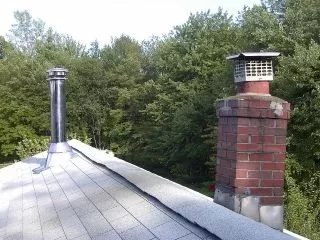

I wanted to mention for the other newbies like me that the hole must
be elliptical i.e. oval! Luckily, I thought of this the day before. Because
when you tilt a circle relative to a vertical column it becomes closer
at the top and bottom than at the side.
The formula is: pipe diameter/COS(roof angle) X 2
So, for 6" pipe, 2" clearance, and 30 degree roof: 14" X 12" minimum.
I did a 15" X 13" to be safe and glad I did!
It turned-out surprisingly well. Whew!
You can use a drywall saw with no problem. Don't put your weight
on the same plank you are cutting. Use a pilot hole from the inside
to put a center screw up thru the roof and make a cardboard template
with a center hole. So all I did was put the template on the screw
sticking out and trace and cut! Viola!
