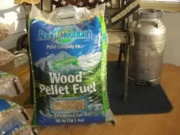

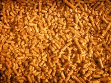

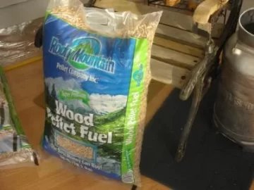

Just some info on some pellets I bought. I've burned 30 bags of these so far and have about 10 left and plan to buy a few more to finish my season. They are a pine pellet and they are produced out of Colorado by the Rocky Mountain Pellet Company. This was my first time buying these pellets and also the FIRST time I seen a pellet come in a see through bag for you to see any fines that may be in there and also see the color of the pellet. Not to mention it had a handy holding handle lol. My results with these pellets have been fabulous. I probably have a lil more fly ash that builds up around my logs set than normal....BUT....absolutely NO clinker whatsoever. I have gone three days without cleaning the burnpot as it burns the pellets up nicely. Probably could go even longer but I dont like to go longer than the three days.
I bought these pellets at Home Depot in Biddeford Maine. I love the fact I can SEE what I am buying. I've enclosed a couple pics....
(the pellet pic came out a little "glowy" as I call it as I had the light on in the room...but they are a lighter pellet in better lighting)

I also bought these pellets at the local TSC. Price here was $5.00 a bag. I'm running a MT Vernon AE and one thing I noticed after burning the Lignetics is that the Rocky Mtn. burned well but very fast, also with much less heat than the Lignetics. The fly ash I had with the Lignetics was very fine where with these it was more of a heavier ash. I would burn these again but for as quickly as they burned I don't know if I could really afford that. I keep my home at around 72 degrees and it does runs 24/7. I easily went through at least two bags a day. I did like the clear bag effect but the pellets in my batch were not uniform or consistent. Actually some were so small they fell right through the holes in the burn pot. I do like the idea of that pellet company making use of the trees that are being destroyed in Colorado. Just my .02 cents.
Yes...the ash is a bit heavier. But i found i could deal with that better than the big clinkers that some brands are producing. Also...mine have not burned as quickly as you posted jj. I have always burned a bag a day on medium on my Quad. If I burn on low i burn a bit less than a bag a day. And have never had smaller pellets falling through the burn pot....maybe its the batch difference perhaps.
