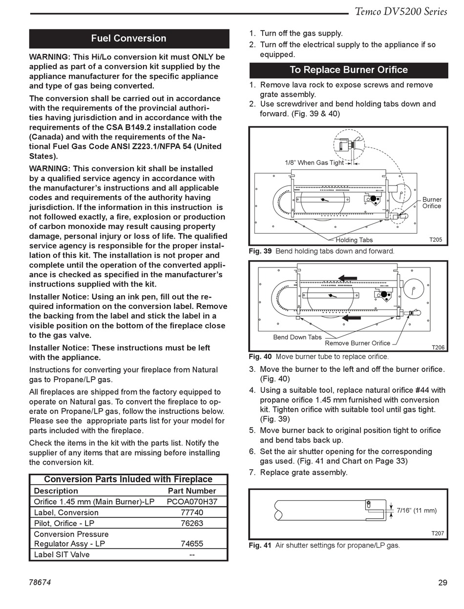

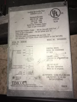

Here are photos of the service plate and the gas control. Fuel conversion for this model is on page 29 of the manual here:
![www.manualslib.com](/talk/proxy.php?image=https%3A%2F%2Fstatic-data2.manualslib.com%2Fdocimages%2Fi2%2F49%2F4821%2F482087-temco%2F29-fuel-conversion-dv5200mb.jpg&hash=44833037a6ff145e1e7c1b5998a99f5c&return_error=1)
Fuel Conversion - Temco DV5200MB Installation And Operating Manual [Page 29]
Temco DV5200MB Manual Online: Fuel Conversion. WARNING: This Hi/Lo conversion kit must ONLY be applied as part of a conversion kit supplied by the appliance manufacturer for the specific appliance and type of gas being converted. The conversion shall be carried out in accordance with...
