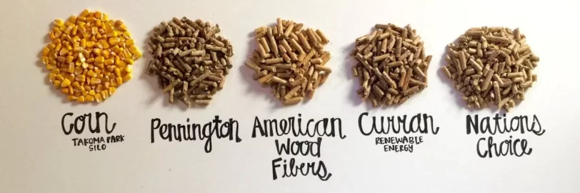

We tested 4 popular pellet brands for BTU, ash and moisture content, and …. we didn't find nearly the ranges we thought we would. We only tested four brands and original idea was to try to find low, medium and high quality pellets. But that turned out harder than we thought.
Check it out:
http://forgreenheat.blogspot.com/2016/01/review-of-wood-pellets-for-btu-moisture_11.html
Does anyone on this list have test reports from pellet test labs that they can share? We'd love to build up a bigger database of all the most popular brands. We used Twin Ports Testing and it only cost $84 for ash, M/C and BTUs. But it costs quite a bit more to also get fines and chlorides tested, which are pretty important. Would love to hear how useful this data is, and if its worth trying to raise some more money and test lots of other pellets are publish the results.

WOW 10% out of a silo...thats pretty darn good. Can't get anything less then 15% around here. I mix with pellets. If I could 10% id burn straight corn.
I have to ask.. where did you get the currans for the test? When where they produced?

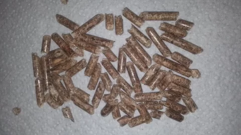

The currans in your picture actually look like a good, decent pellet. Uniform in color anyways. The currans i have and absolutely hate look nothing like what is pictured. They are the mixed as well. They are more blackish than brown and burn just as bad as they look!
We bought 2 batches and the Twin Ports results are from the second batch, which we bought in September. The first batch we bought in June and they had really low moisture content (3.7%), ash was a bit higher (.67) and BTUs a bit higher too (8,261). We are reporting BTUS, etc. "as received", not "moisture free." Both looked about the same and burned pretty well. The seal on the bags on the second batch was not so good and a bunch of the bags split open if you weren't careful and held them upright.

Here is a pic of the currans i have. Bought in sept/oct. They actually look much darker than they seem in the pic.

The AWF Ultra had the best result, highest output, lowest ash. Seems to compare spec-wise to the doug fir Blazers that many of us burned last winter when there was a surprising supply in the northeast.
