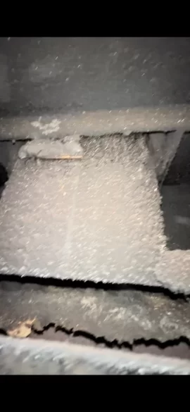

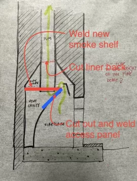

Not sure if its a heatilator or not.
Definitely earlier than 1950s. After noticing a lot more smoke in the fireplace to our cabin (purchased 5 years ago) following a renovation, I decided to investigate. Looks like the flue extends lower (intentionally) than other Heatilator designs I've seen to some kind of "down draft shelf".
Clearly some deterioration of the portion that directs the smoke beyond damper. I'd love to repair this, just not clear what the design of it is supposed to be like since a key component looks like it's rusted away.
Any advice or guidance on how this is supposed to work or experience anyone has had with this would be greatly appreciated.
