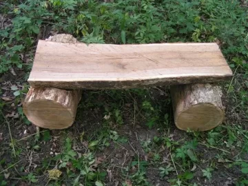

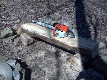

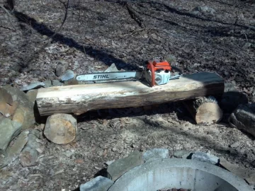

So we did a small cleanup job this morning, mostly all silver maple blowdowns and leaners. When the client came out and asked if we would cut him a bench out of one of the nicer logs so he could use it for his firepit. Oh, well. Heck it was only a couple billets' worth! Ripped a slab off of one side of a 7' log and made cradle notches in two of the billets for legs, voilla! :)

It's stuff like that, that can really make the job. That customer will be so happy your sure to get referrals. some times the
little extra can make them let other things go that they may of other wise not have. Like not so picky on clean up etc....
Nice job !!!

Are you all using some kind of proccessor or just noodling a 4'ish log by hand and eyeballing it? I think a couple of those aroung the fire pit would be nice.
that's around a 7' log, and I eyeballed it. Its not too hard to do if yer chain is sharp and your throwing good oil. I set it on two cradled junk rounds to slab it. My wife really likes it so I guess we're gonna be making more! I'm gonna hold off til I find some hemlocks...
So basically, if you are careful and pick a good log you get two for one by just runing the saw down the middle and putting a wedge in the back end as you get into the log a ways?
Looks like some fire pit furniture will be a future project for me
Yeah it's actually pretty easy, just make sure your chain is good and sharp, and you keep the oil flowing, and take your time. I eyeballed it (would be easier with an Alaskan style mill) and only took the top 1/3rd of the log off. The two rounds it is sitting on were notched in the top to cradle the log. It's actually fun up to the point when you realize you just lost two or three nights' worth of firewood to make the dang thing!
