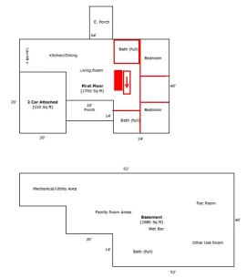

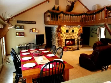

I am not looking to heat my total square footage necessarily, but If I could that would be great. When we burn we usually try to run our air handler on medium, even if it is not heating, this does a good job of circulating the warm air from our living room area throughout most of the house. I have attached our floorplan to help with input. The ground level is only 1760 sft, but living room area is rather large and has cathedral ceilings that are about 16-17ft to the peak. So there is a pretty large air volume in our main living area. We also have over 2800 sft in the basement area, so some of this heat may be able to be utilized there too.
The floor plan shows the fireplace location (red) and the stairs to the basement right behind it. All of the kitchen, living room, and hall space behind fireplace is very open floor plan, and the stairway to the basement is very open as well.

Size will depend to a certain extent on what happens with the heat. Any of these fireplaces should heat both the main floor and the loft area. For the largest it might be reasonable to dump some heat into the basement area if the fireplace permits powered remote venting below the fireplace.
