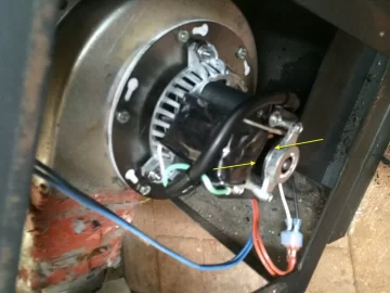

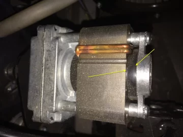

Have you guys seen the new Harman upgraded exhaust blowers and auger motors with the new black spacers to seal out dust and dirt to make them last way longer?
I cannot wait to throw these new babes in! See yellow arrows in pics below.
