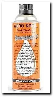

If you could find or have KROIL ,soak the threads and let it sit over night next day hit it again , third day give it a try this penetrating oil works like magic .
