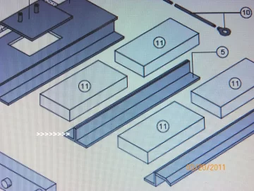

Can't you remove the rear baffle support (page 25 in your manual #5) and remove the bricks without removing the tube.
Zap
  • [Hearth.com] Remove pins on Lopi air tubes
