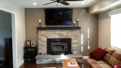

Hi all! I haven't visited in several years, but have been happily burning my Regency insert. I wanted to share my fireplace remodel and maybe provide some tips for anyone contemplating the same thing.
We had a contractor remodel our complete first floor this year. Our fireplace was very dated and we hated the bricks. I researched several alternatives including several different types of imitation stone. Brochures looked great, but seeing the products in person left a lot to be desired. We ended up choosing a natural stone ledge rock since we were trying to pull out grays with our remodel. I also wanted to do a dry stack, but ended up using some mortar between the thin joints.
Since this area is narrow, I wanted the TV mounted above the mantle, knowing this is not the ideal spot, but I wanted to have full view while in my kitchen...think long area. I asked the contractor to remove a few bricks to recess an outlet. Long story short, from my existing mantle to the ceiling brick facade was not attached to anything on the exterior structure. Approximately 3 1/2 feet needed to be removed, which suited my wife and I since I really wanted sheet rock above the new mantle.
After choosing a stone, I contacted three masons and only one returned my call. He wanted $2,400 labor only. Being the cheapskate that I am, I ended up tackling the project myself. Total cost of the materials were about $820, which included the hearth, stone, veneer cement and some blades.
I also made the mantle and recessed some low voltage LED lights that are controlled by a remote control with dimming capabilities! Total cost was about $120. The new mantle sits approximately 3" off the stone and is removed with one slip bolt which hides the wiring.
Due to some major construction issues(cabinets, new hardwood flooring...) I wasn't able to have a real fire until the other night. No stone fell off, so I guess I did it correctly!
Keep in mind, every stone was cut! I also cut the surround down so more of the natural stone could be seen.

![Remodeled my fireplace/insert! Remodeled my fireplace/insert!](https://www.hearth.com/talk/data/attachments/186/186788-fe76d5d260b28ed2506524b30f110431.jpg)

![Remodeled my fireplace/insert! Remodeled my fireplace/insert!](https://www.hearth.com/talk/data/attachments/186/186781-8e04c203b8b448651e3d1bf566d98d68.jpg)
