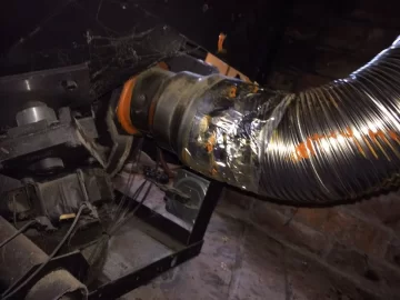

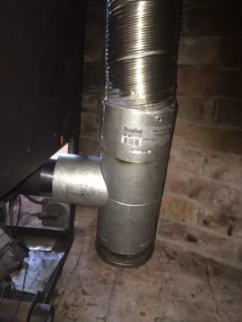

This Enviro Meridian Insert did not have a Cleanout-T so it plugged up easier. The new close clearance Adapter-T has a built in stove adapter to fit in the back of the fire place insert exhaust flange and make the stove much easier to clean. Also if a small amount of ash builds up it will not choke the stove!
Pic 1 - 4" liner connected to adapter to stove flange
Pic 2 - Cleanout adapter T connected to Flex adapter to 4" liner
