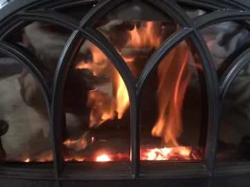

So i mentioned before, i'm not great with reloads.
The main problem is they take to long to start burning clean.
I hope this thread can show good pics of different reloads on different size coal beds and in different stoves so we all can see what might help us in our own stoves and situations. Thanks in advance for everyone's input.
I'll start with my reload on small coal bed this morning.
(In my mind the below takes way to long to get burning cleanly.)
All oak splits. (moisture around 18% on fresh spilt room temp.)
2 sleepers on the sides of the morning coal bed raked forward. (Not a lot of coals)
Bottom row topped with 1 sleeper to increase air flow.
This load was for more heat and faster lighting vs. long burn time.
From coals to 3rd pic took 20 minutes. (still not burning strong yet)
From coals to 4th pic took 35 minutes. (good burn now)
From coals to 5th pic took 1 hour. (Perfect cruising)
