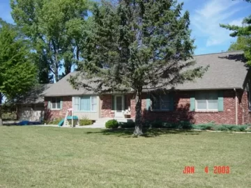

i took down a spruce tree july 9th and split it within a few days. i didnt want to burn it it the stove only because i have a lot of good wood(oak,locust,ash) available, so i saved it for camping. i was shocked, 2 months after splitting it burned fine.
here is a pic of the tree that made roasting marshmellows and hot dogs possible last night. may she rest in piece
