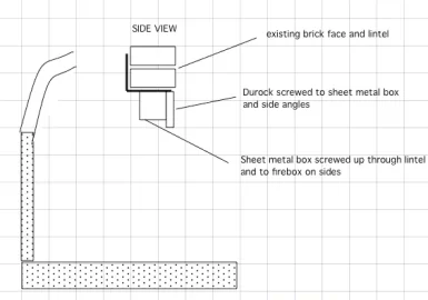

If the existing lintel is still there, I think it would be possible to lower the opening without dealing with heavy weight materials. A "frame" of steel studs or a home-made sheet metal box with a layer of Durock screwed onto it should do the job.....but it would need to be done by someone fairly handy using lead shields or tapcons for fastening to the masonry. The enclosed sketch is just a guideline for something which may work.
  • [Hearth.com] Reducing height of firebox
