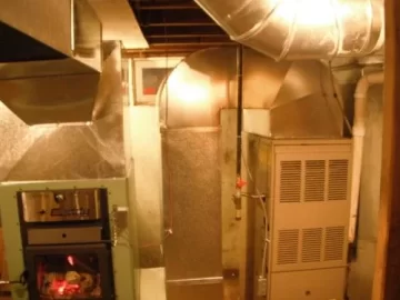

Ok, looks like this may have worked, so about this install:

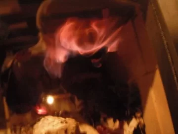

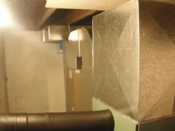

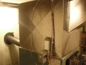

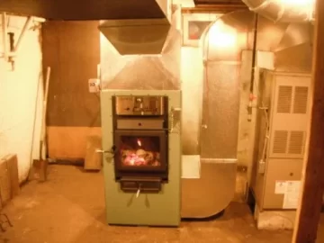

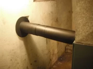

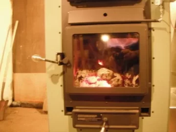

This customer had an old Monarch wood furnace in his basement installed as a stand alone unit with his lp furnace as backup. The old furnace had to be removed in chunks. He bought a PSG Caddy add on Model 1500 from us. We installed it so the blower from his gas furnace would push the heat thru the Caddy and switch over to gas automatically if his wood ran out. Had to redo some duct work. His old furnace plenum had charred the beams above it over the decades. All went well in the end. He's getting nice overnight burns. Heating a 1600 SF ranch and his full basement.
Dont know if posting pics of installs here violates any policies. If it doesnt, I'd be glad to do more of them.
